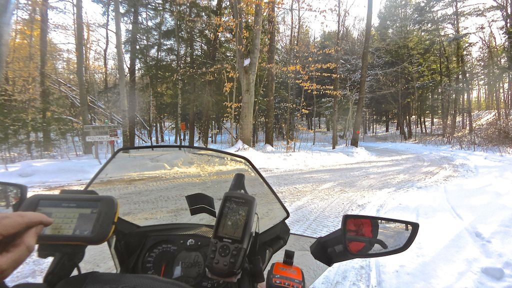

This is a pic of the setup on my 14 Vector LTX. Don't have one of my 05 Vector which is NOT mounted on the bars.

I normally run a Montana and 60csx, though I don't recommend 2 units for the average bear.

Running 2 units gives me redundancy (if one flakes, the other should be fine) and I can also run 1 at the "big view" and the other at the "super detail" level.
