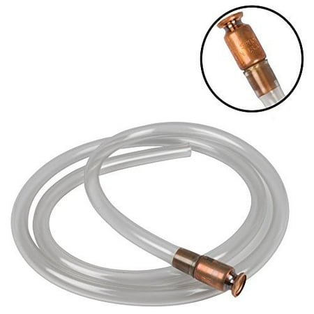

these shaker siphons work really well
wirev
I agree, Snobuilder, those hoses are the best. Never a problem and they work fast. Got mine at the Derby a couple of years ago. They now sell them at the Championship Snowmobile museum next door to the Derby.
