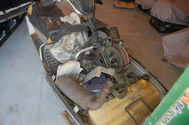

With respect to the subject sled, since it was an on-line purchase and when I finally did pick it up, I needed to make a quick, one day turnaround trip to the Twin Cities, I didn’t really have a chance to really look it over until I got it home. I have to admit that, at first glance, I had to really squint to see the potential.

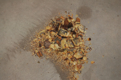

I knew the motor needed work but I didn’t realize it had been pulled until the fellow storing it handed me a heavy item wrapped in plastic and said “here’s your motor”. Turns out, it was just the bottom end. The rest of it, including one badly burned piston is all in here:

Actually looks better in the early teardown stage and yes, there is a dead mouse in the last shot. From the look in his eye, it was not a good way to go.

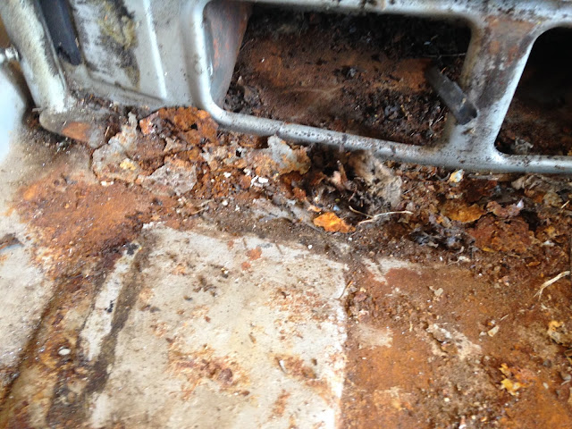

I suspected that the drive sprockets were bad and my suspicions were confirmed, doubt if they would have made one turn of the shaft under load. Looking at the pile of teeth, I’d say it’s about a 2.52 pitch.

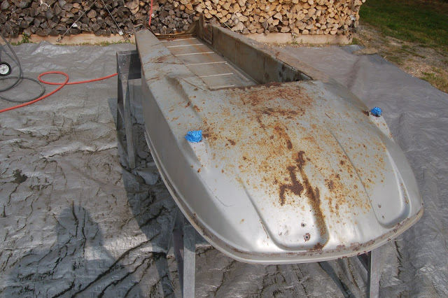

Chassis teardown complete, let the sandblasting begin. Luckily, I was able to get at this earlier in the fall before the snow flew. Not the most sophisticated operation but I am able to recover about 80% of the blasting material and reuse it after screening it. When I find a photo of the results, I’ll add it later.
