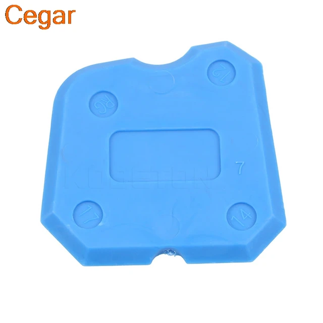

there is a plastic scraper used to lay a good bead of caulk at paint store with radii on edges and smooth edges all around....I use one of those and some WD-40...I spray then use scrapper to left sticker a tad....then spray as I use my fingers or that scrapper to keep pulling gently off.....spray all the while....spray and peel.....trying to keep sticker whole as I pull...then to get sticky glue off afterwards I wipe off spray and use duct tape as a blotter to get sticky glue to come off with duct tape....comes off easy this way IMO
4pcs-Tool-Silicone-Grout-Remover-Plastic-Scraper-Sealant-Joint-Scraper-Caulking-Tool-Kit-Hand-Tools-Kitchen.jpg_640x640.jpg
