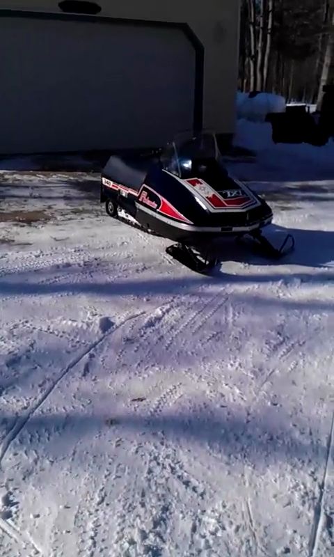

Heres my first Vintage Project........TXL 340

Thanks guys, you both were a big help. It is still a long way from being done, but we're making progress.
I was surprised how different it sounds after getting up in rpms........it sounds real good.
After just hearing it idle this whole time, and it being only a 340, i'm impressed with the power this thing makes.......
Brad is right, we need to get together some day for a vintage ride.
I spent many late nights trying to get this sled rideable before the snow was gone,
and with a few more adjustments i think we will make it. Been steady progress since i bought it January 1 2015

Great news folks,
I got the old TXL out for a 5 mile ride
today, just to get a idea how it's going to handle. Other than a low idle, and a inoperable speedometer all systems were OK.

Well Here is a short video of the TXL running for those who wondered how it sounds. Went for another short ride this afternoon and got a little noise to share..........
