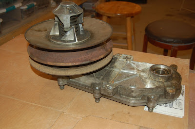

Thought I would post a couple of shots of the last drive train holdout, the chain case and secondary clutch. The clutch shaft bearings felt really good – smooth and no play, so I decided to clean things up without tearing it down completely. Cleanup took a little more time I’m sure but it did eliminate disassembly/reassembly.
This completes the parts needed to re-install the drive train (track, rear suspension, drive axle, and chain case/secondary assembly).

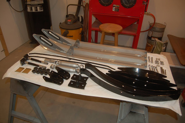

Even though the drive train is ready to install, this process is made much simpler if the skis are mounted – makes the chassis so much easier to maneuver if need be. If the sled has been allowed to sit outside, the skis really take a beating.
I did get the ski components done before the extended “vacation”. The skis and springs almost always have rust pitting and if I were building a show sled, I would have used glazing compound to eliminate the pitting but no, that’s too over the top, even for me.
Love it! Again, appreciate your process, it's really something to admire. Hope your feeling better, just don't overdo it. -Mezz

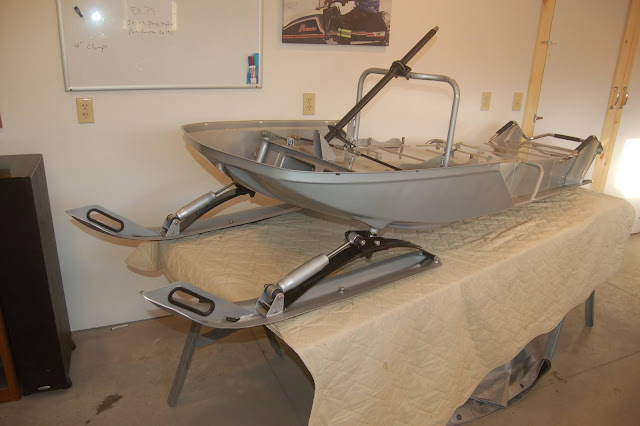

I know I wasn’t supposed to be tempted but I just couldn’t look at all those parts and not want to put something back together. I had forgotten a couple of other things that needed to get installed before I got serious about working on the drive train (steering shaft, tie rods, and rear grab bar) so I mounted those, along with the skis. A long way to go but it’s nice to see it on its front feet.
(For those of you that have been following my posts for some time, you probably noticed that I finally built some doors for the doorway between the shop and the sled storage area. No more plastic curtain - only took about three years.)
