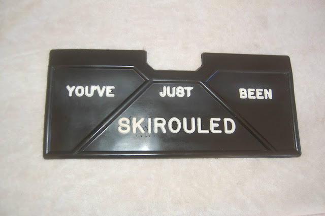

I’ve been pretty discouraged about the lack of progress on the project but I couldn’t help but break out in a big smile when a brand spanking new reproduction snow flap arrived today.
This will be a nice finishing touch to the sled when it is finished (and yes, I’m committed to finishing it).

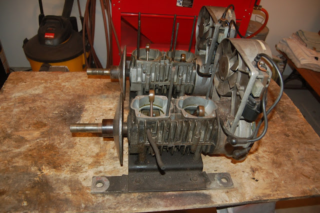

This is sort of a tale of two motors. I could never get spark out of the motor from the donor sled and finally gave up. The motor that came with the project sled is a complete unknown but it obviously had spark when it fried a piston. So, my plan is to put the pistons/cylinders from the donor sled motor on the other motor. The pistons/cylinders aren’t that great but I showed photos to some Sachs guys and most said “Send It” so that’s what I’m going with.
